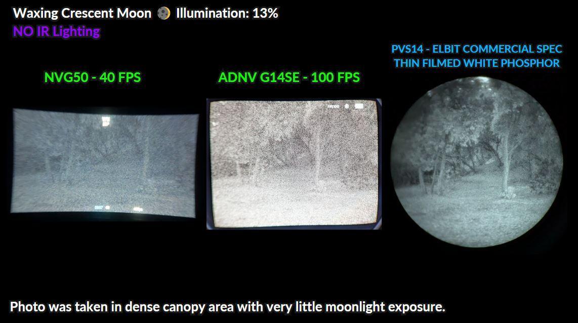

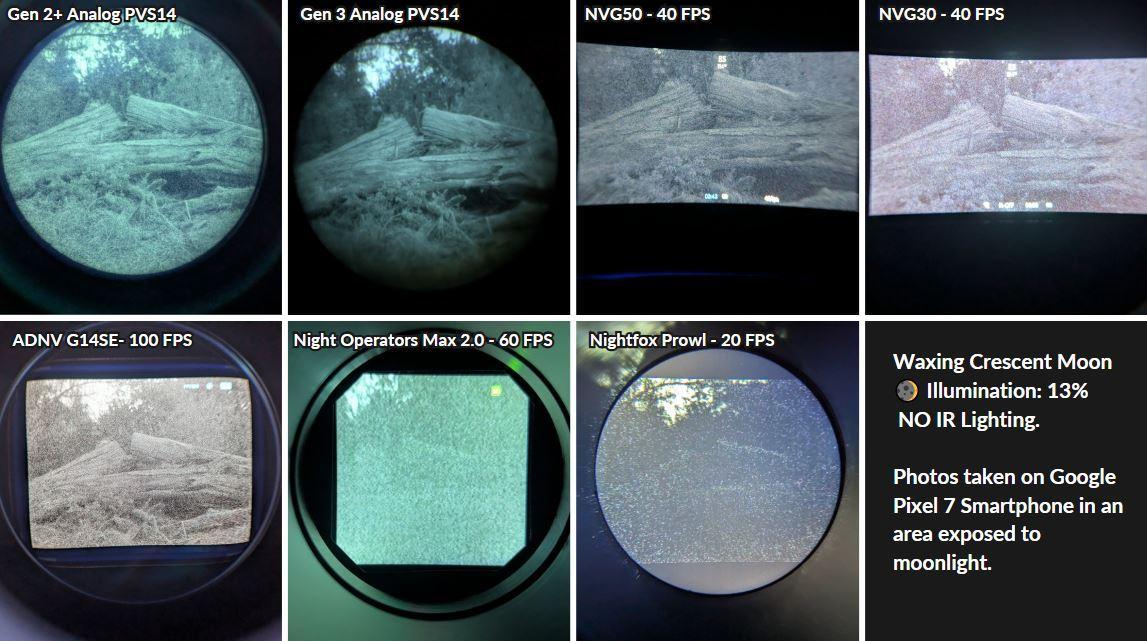

Bi nods are cool, but start off with a mono and mount it to your rifle.  In order to get a quality optic, you'll need to spend A LOT of money, especially white phosphorous.
Bite the bullet!
Bite the bullet!
Gonna have to push back a little bit here. Even though the mounts exist, most NV monoculars are not rated to handle the recoil of a rifle. Mounting them to a rifle can lead to damage anywhere from image blems to the unit just suddenly quitting working entirely. It is very much not advisable to mount them directly to a weapon.
