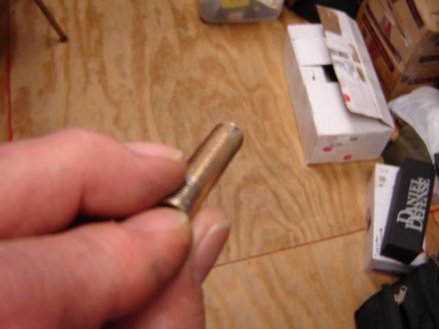

Pillars are lamp repair post (can purchase at any Lowe's or Home Depot) they thread into the existing holes for the action screws. I make a tap from one of the post by cutting 4 "teeth" and putting a slot in the other end for a large screw driver to bite. Run the tap through, and then it is easy to thread the actual pillar, which is trimmed to correct length in.
