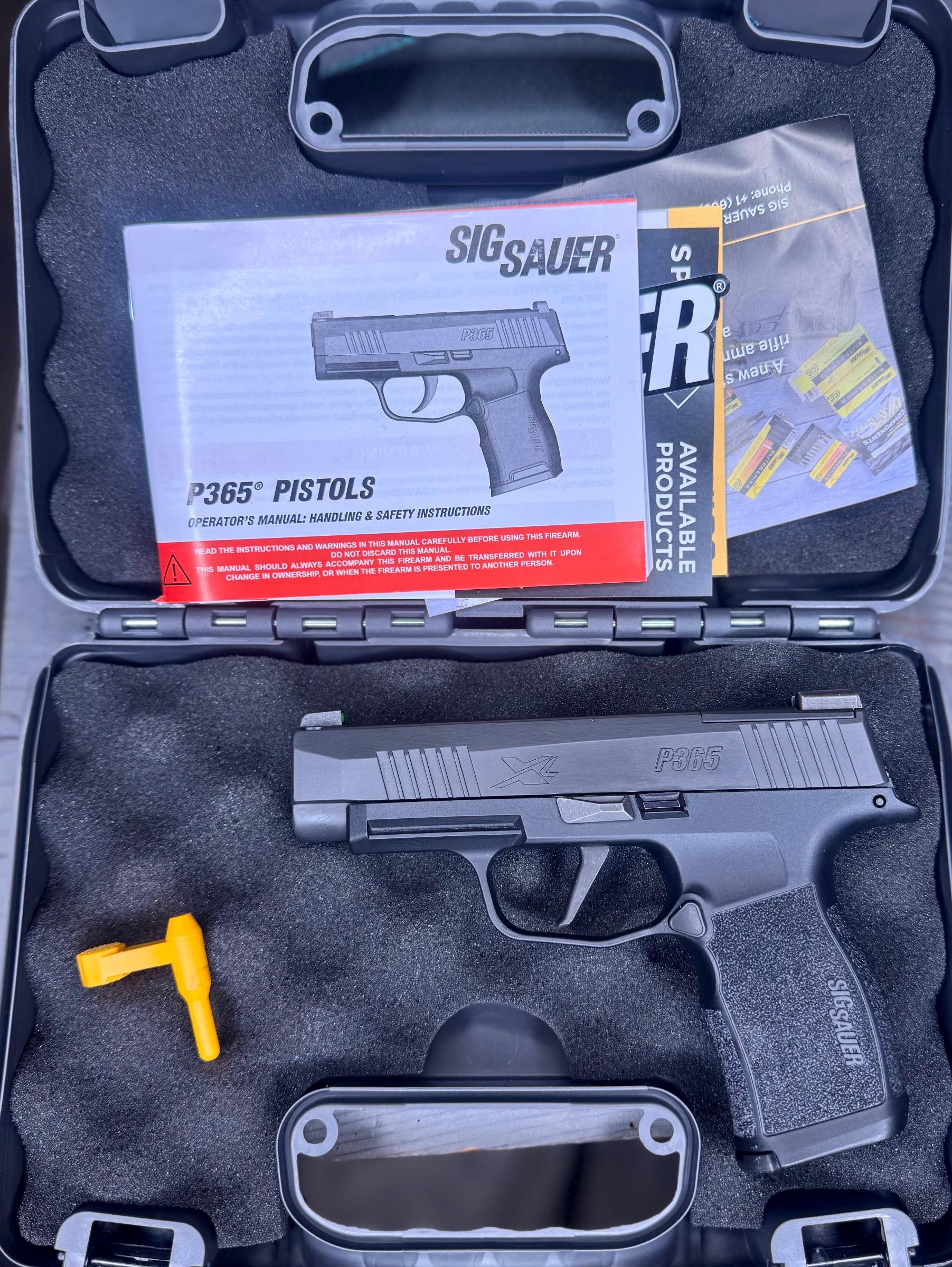

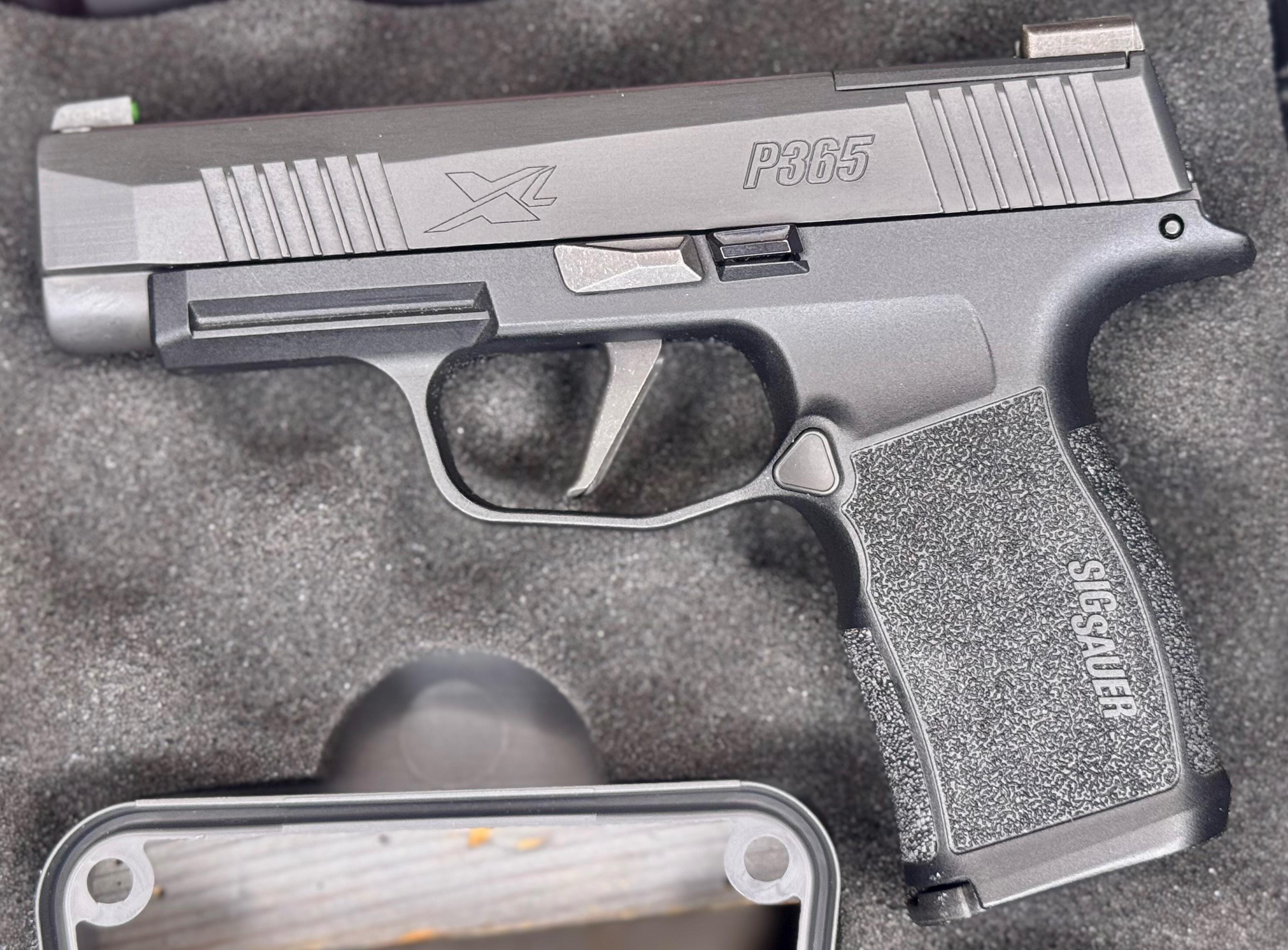

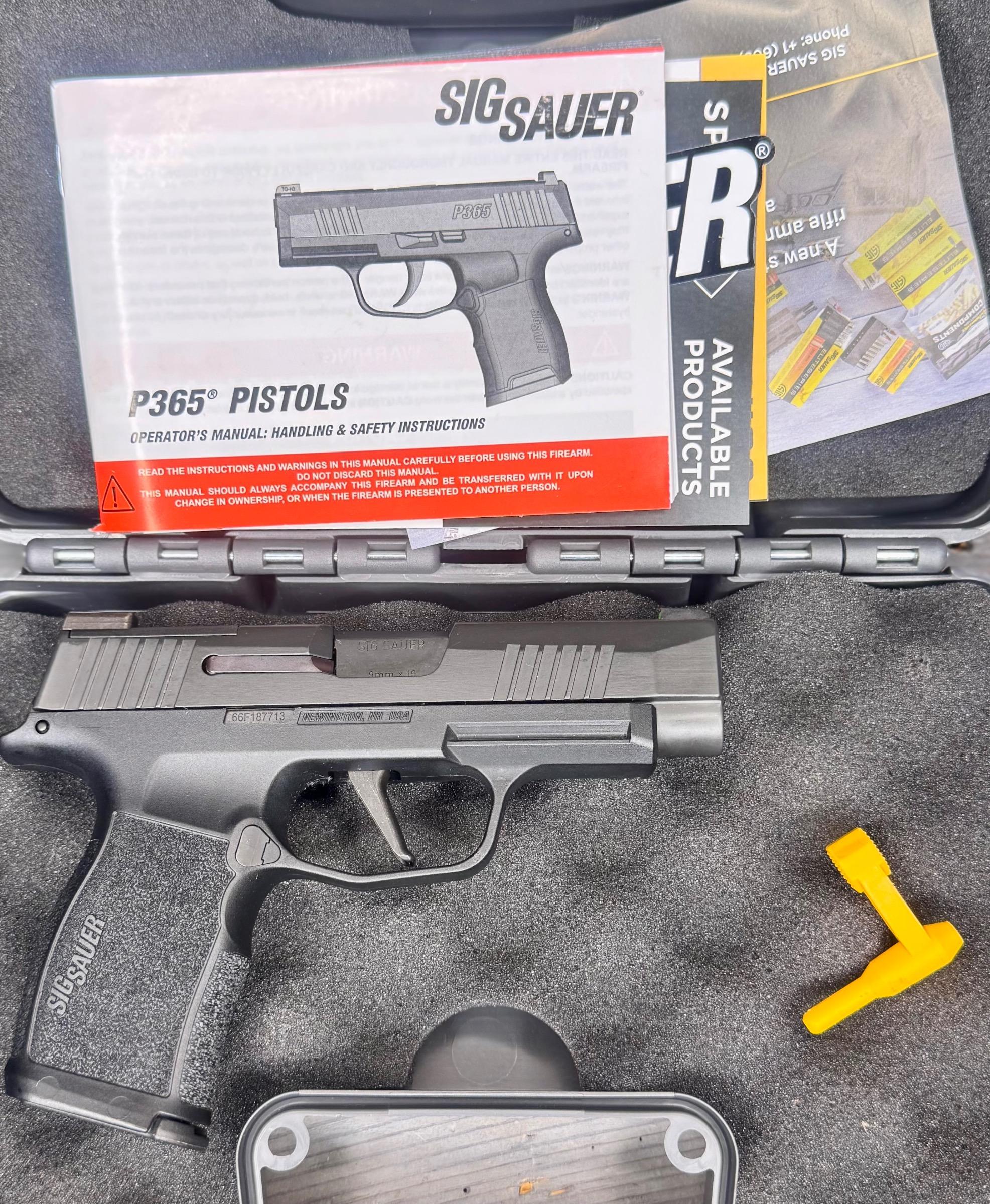

  3. This one is brand new and unfired. $500 FIRM - Night Sights - Optics Ready - Factory Case & Paperwork - Factory Mag (just as it shipped) Must be legal to own and be a TN. Resident. TEXT IS BEST! 615-504-1491
