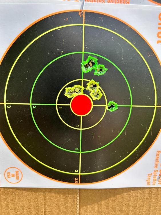

100 yards with Speer 125gr TNT-44.0 Accurate 2520-
I have no doubt as to the accuracy of this load-I do however doubt my ability to make myself more accurate with the tools I have at the range-馃幆

Thanks much for the data-
It's kind of what I had thought-44.0 grains seemed to zip right along and give no stress marks or primer flattening-
I think this load is the one I will stay with-at least where 168gr is concerned-
