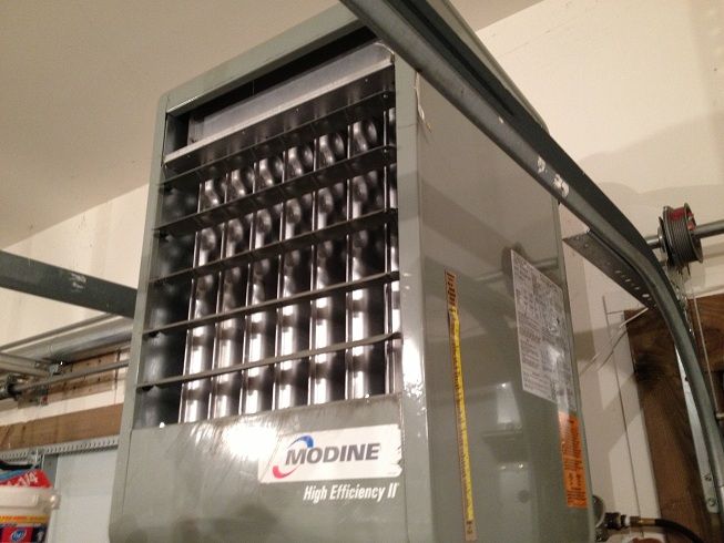

This is what I do with my shop.  It seemed like the best source of heat that had the least chance of creating a fire that would set off a lot of powder.
